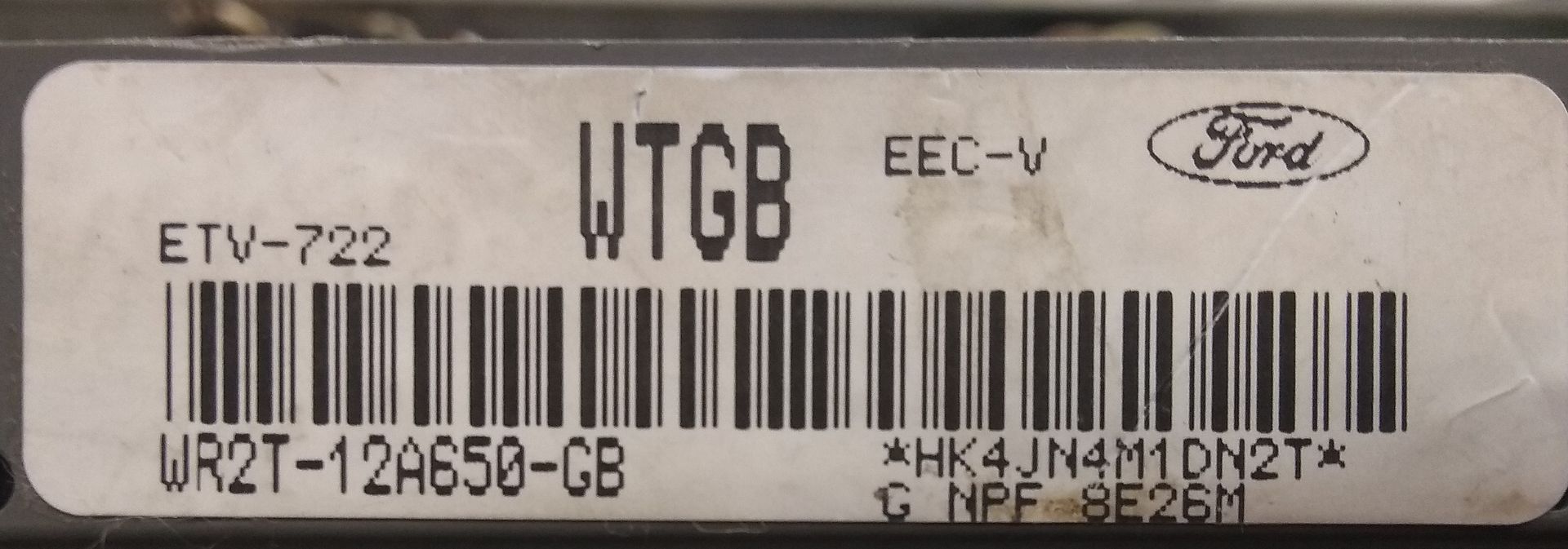

I have an Australian '98 Ford, 5.0 with EEC-V. Catchcode is WTGB, WR2T-12A650-GB.

WTGB is the NVXN6 strategy.
The only info I have on any imported ford cals is 12JB / NVXF4 strategy. Its a manual trans 5.0 in that era. AU3 5.0L Smartshield 220kw XR8 according to TIP.
