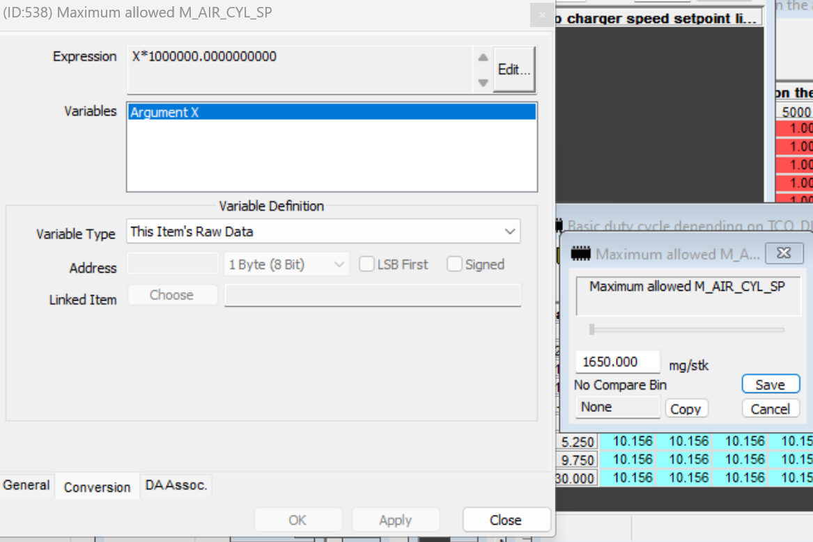

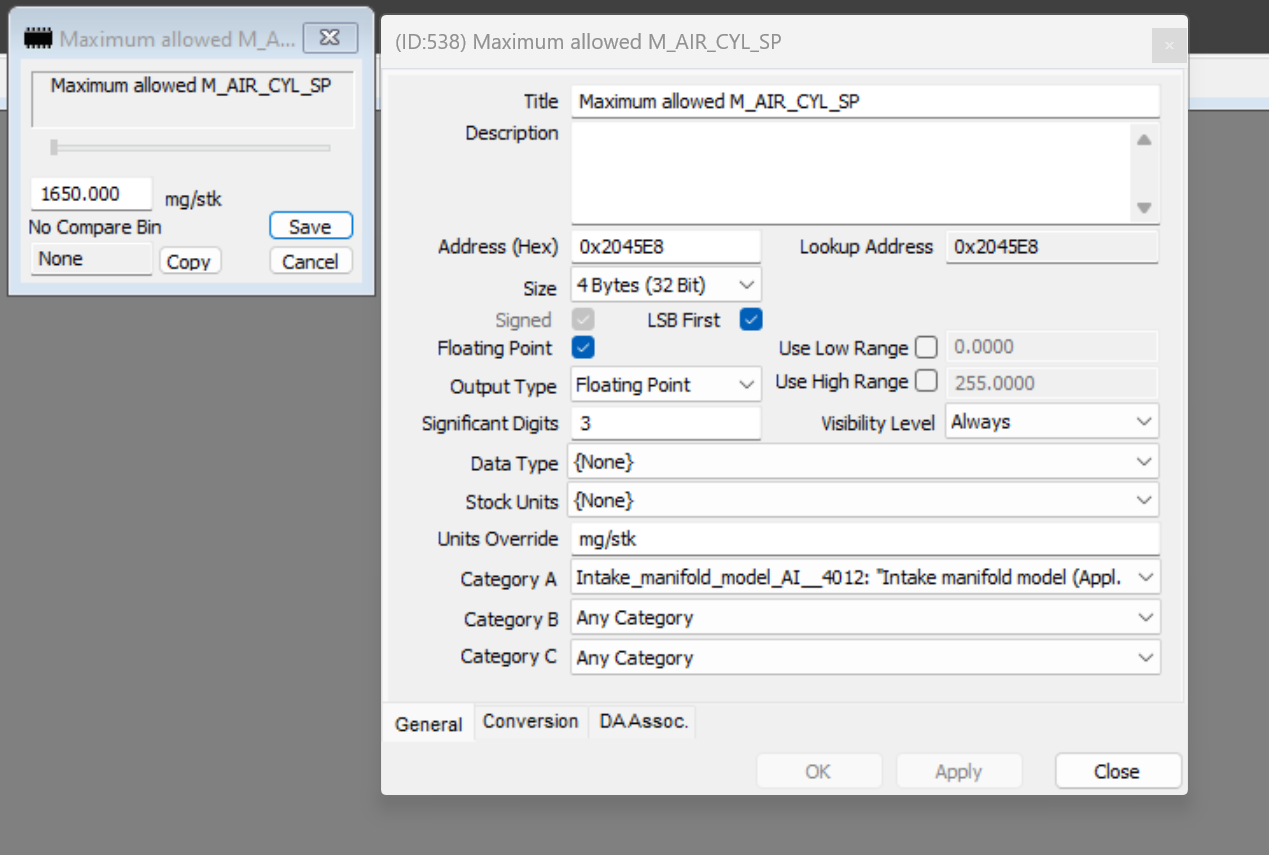

So I have a file I exported from another software to XDF which worked will. however I'm merging the data to my normal defs as I prefer the way they're laid out by feature rather than function, in the import theres a 32 bit file that has a conversion and works fine however when i'm trying to make that table in my other def it gives me an error saying there can't be any conversion
i've tried doing it as a table and scalar to see if that changed anything but unfortunately it doesn't
working def
working def
Screenshot 2025-06-10 123846.png (199.55 KiB) Viewed 45579 times
NEW DEF error
NEW DEF error
Screenshot 2025-06-10 123910.png (214.64 KiB) Viewed 45579 times

What you're seeing is currently by design. You cannot have a conversion for 32-bit floating point values. At some point in the future I will add support for this by adding two-way conversion.

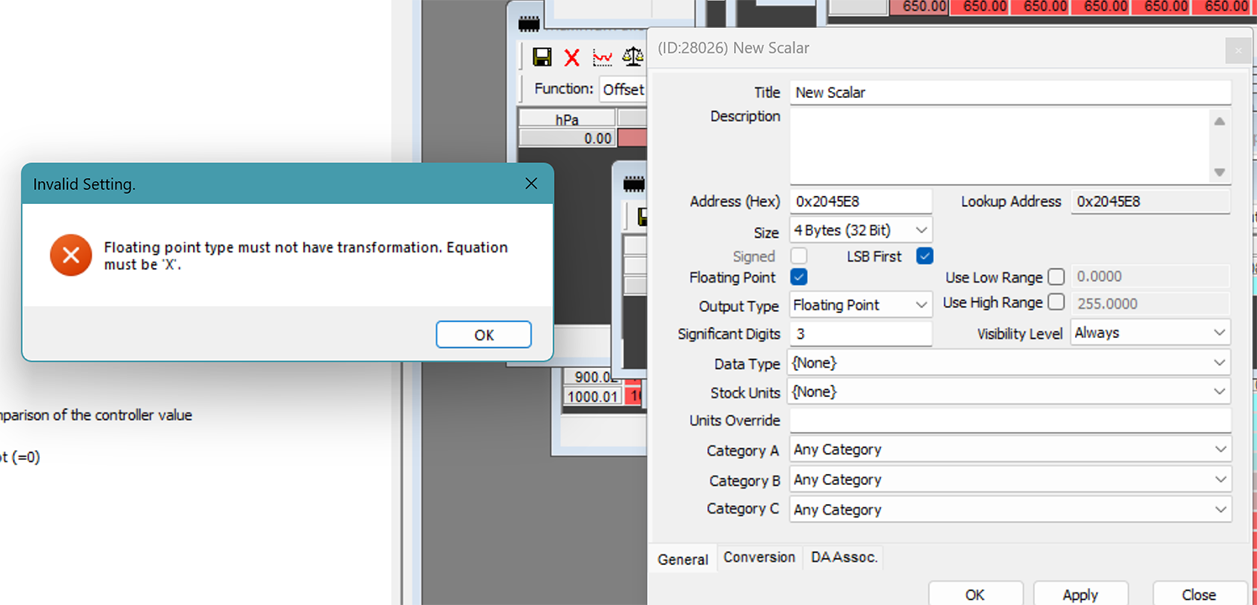

yea it does the conversion i know the working one is a scalar vs table i've tried both ways
working
working
Screenshot 2025-06-26 150342.png (224.9 KiB) Viewed 44271 times
error
error
Screenshot 2025-06-26 145828.png (239.42 KiB) Viewed 44271 times

If you change the value of the item that has a conversion, then save it, then re-open the editor, does it work? =(

it ironically seems like it's doing the calculation to what I put in so kind of working but not really .. it shows as 1500 stock on the table.. if i change it to 1700 on the table it makes it 1700000000 and the expression is x * 1000000. however if i type in .0017 and save it makes it 1700 lol.
