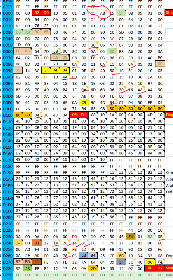

Fun fact #2 the checksum location can be moved. There is a table of locations that defines the checksum region.

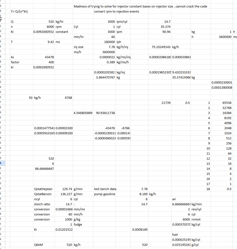

Fun theory #2 injector size affect on injector constant if you are changing it
Not a complete list but a summary of roughly what the values are.
4 Ways of looking at the same information:
pn..........;descrip......;#/hr..;Inj.C.;Hex..;Factor
280150415;95 m3.......;17.16;43478;A9D6;1.000
280150440;Pink 96m3..;21.50;34702;878D;0.798
280150927;-.............;23.50;31748;7C04;0.730
280156370;alpb3s pink.;23.80;31348;7A74;0.721
280150947;Blue.........;25.50;29258;724A;0.673
280155715;Light Blue..;25.60;29144;71D7;0.670
280150218;-.............;31.32;23821;5D0D;0.548
280150934;-.............;31.32;23821;5D0D;0.548
280150945;red..........;32.10;23242;5ACA;0.535
280150431;-.............;35.64;20934;51C5;0.481
-............;Dark Blue...;39.77;18760;4947;0.431
280158227;-.............;41.43;18008;4658;0.414
280150558;green top..;45.20;16506;407A;0.380
280158123;12ohmev14;62.86;11869;2E5C;0.273
280158040;-.............;90.48;8246;2035;0.190

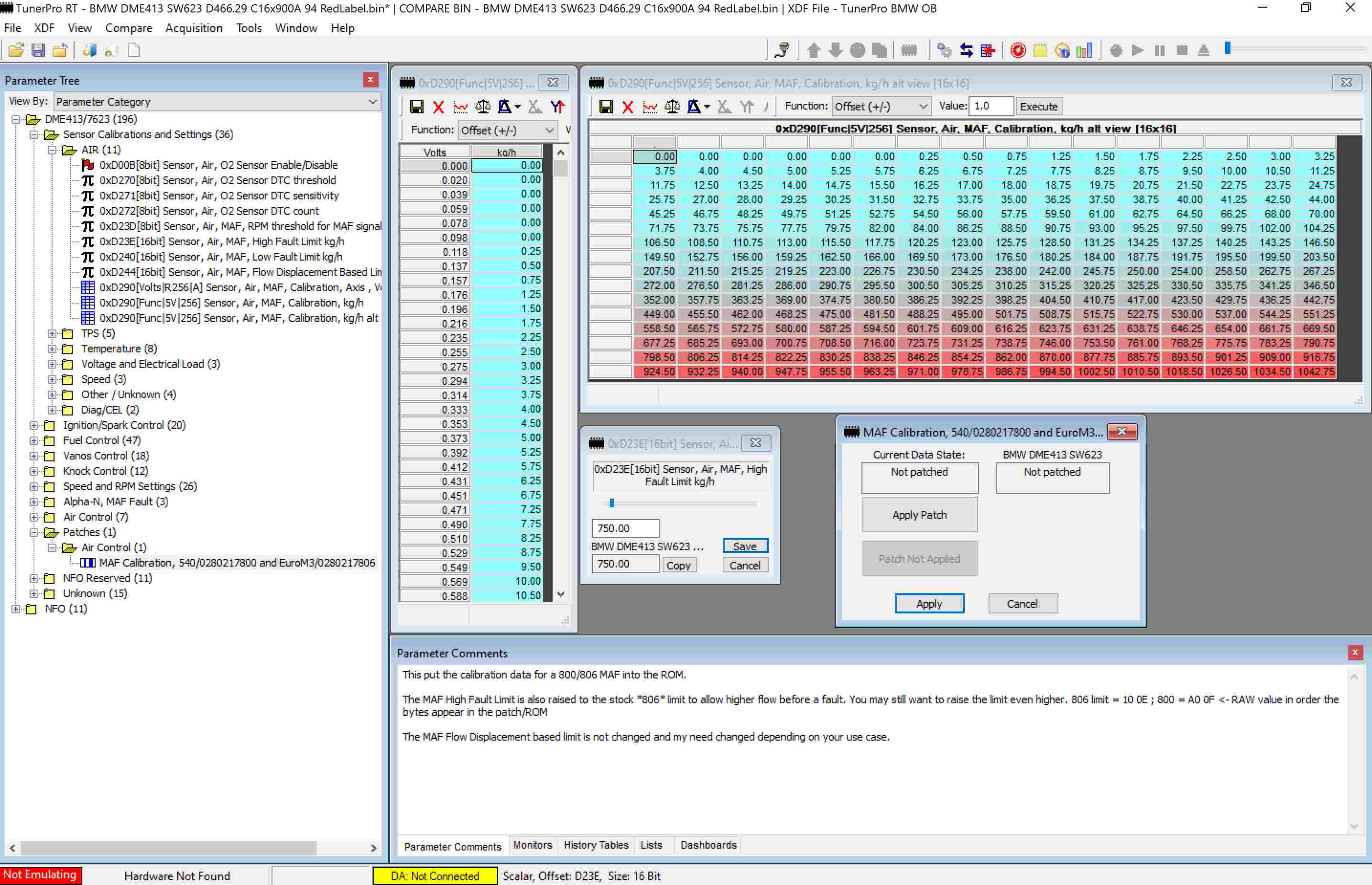

kickingklutch wrote: Mon Sep 30, 2024 3:45 pm thank you for the work your willing to put into this man i myself have recently gotten into tuning my obd1 325i and the mess of information is stressful if you need any help in anything feel free to let me know my knowledge is currently slim but you never know
Thanks had PM'd me about a value the 413 xdf and where it is at in the 506
"BMW OBD1 Bosch M3.3.1 HW413 xdf from you on github vss limiter is there as 0xD27E in the hex is it something i can look for in 506?"
Yes it is there, shifted slightly. This is the engine RPM limit when no VSS is present. Is is not used unless your VSS is broken in some way.

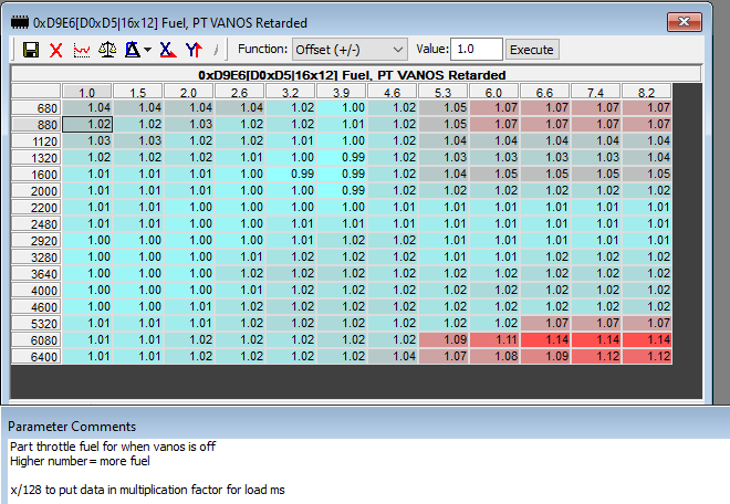

How should fueling correction table data be viewed? What is the most correct?
Main fuel tables are RPM v. Tl(Time Injection Basic)(ms). The data in the table is correction factor at that point. Over the years of following this topic most people,I think, and most public XDFs for sure do one of the following with the table data:
1. leave it as a raw decimal value with 128 being zero correction ; conversion = x
2. converted to lamba / This is also becomes what could be viewed as a multiplication factor after converted ; conversion = x/128
3. Converted to afr ; conversion = (1-(x/128-1))*14.7 (or similar, I can't recall the eq used)
#1 is reasonable to just leave it and not worry about it. More is more fuel, less is less fuel
#2 lamba NO but, multiplication factor yes. Depends on how the program uses the data in the table.
#3 Just NOOO its not AFR
Have seen Olafu post that 64 = 0.5x fueling and 255 = 2x fueling which leads to believe it is multiplication factor.
Also the old Jim C quotes posted all over are OG source.
Tl = Q / (n * Ki)
With Tl quantified, we now take into account the vagarities
of the particular engine family and operating conditions by
introducing multiplicative factors to correct the theoretical
injector time to the ACTUAL time for injection (Ti) needed
at that instant. Finally an ADDITIVE factor (Tv) is added to
compensate for the differing injector opening time under lower
than nominal voltages.
Ti = (Tl * [C,D,E...]) + Tv
JimC
data as factor of correction.PNG (32.88 KiB) Viewed 128085 times
So I think the best/most accurate way that all the correction maps should be viewed is with data conversion factor as (x/128). Does this seem to be the best way to format all the map data as we continue to drive to a point to complete the equation Ti = (Tl * [C,D,E...]) + Tv

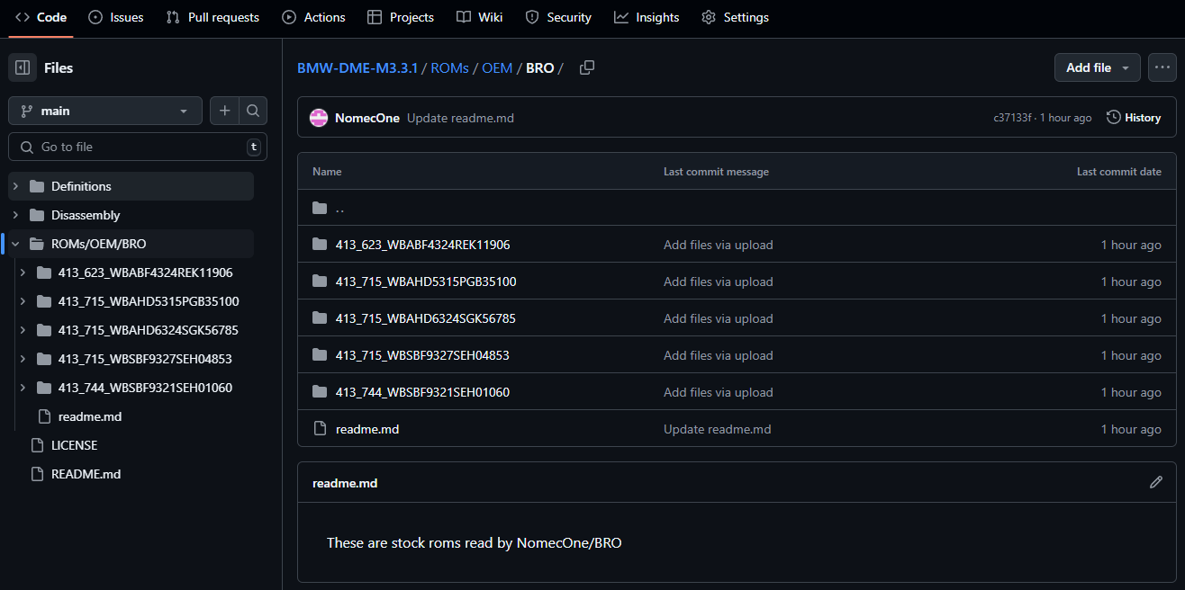

I have added some ROM reads that I personally have taken to the github. I have more to put there but I have to label and organize them.
I have an oddball 744 software version of the 413 ROM. I have not crossed the 177 or 609 software versions in the wild yet.

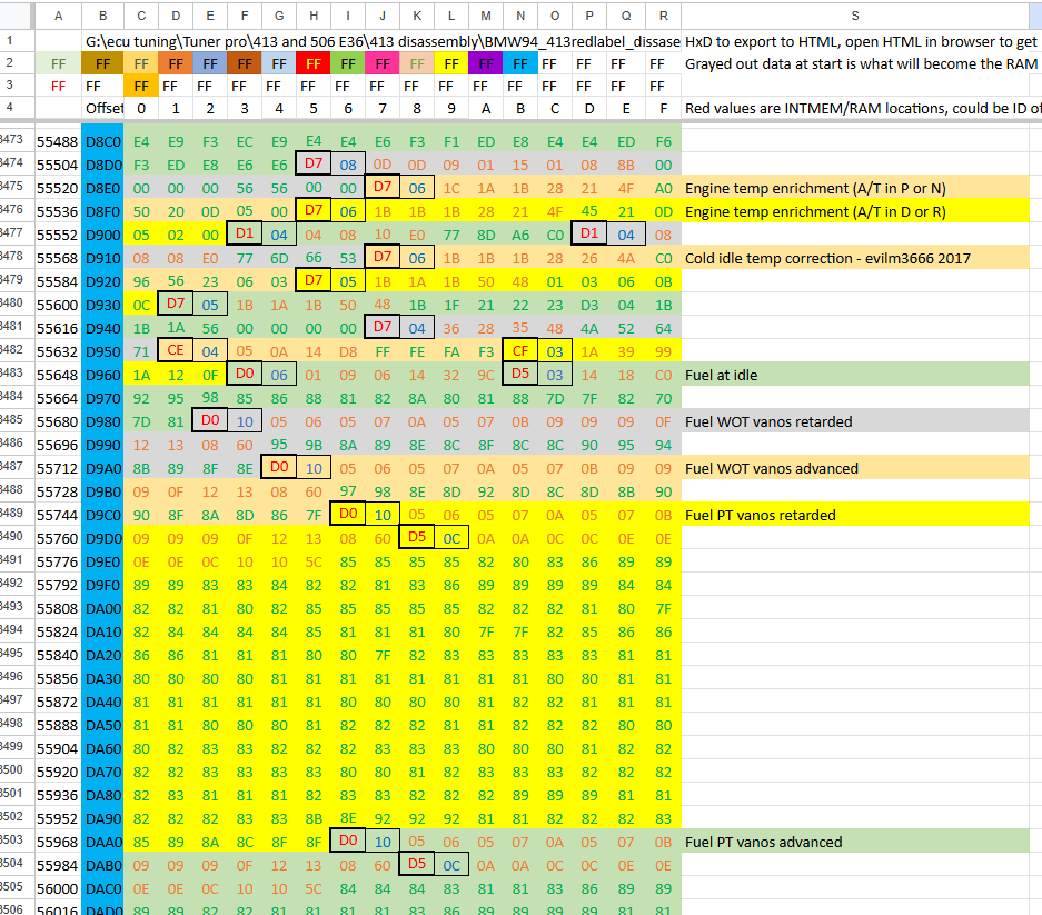

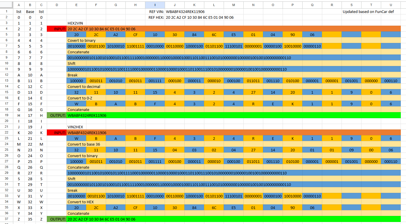

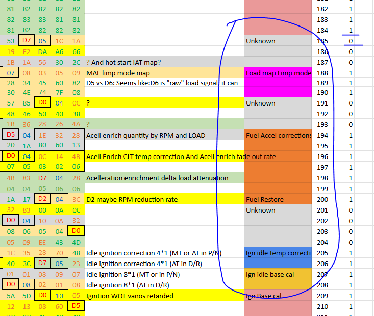

Also some screenys of the google sheet to define the 413/623 ROM. A lot left to clean up and a lot of undefined values left to uncover and document.
sheet example1.PNG (98.38 KiB) Viewed 127639 times
sheet ex2.PNG (132.79 KiB) Viewed 127639 times

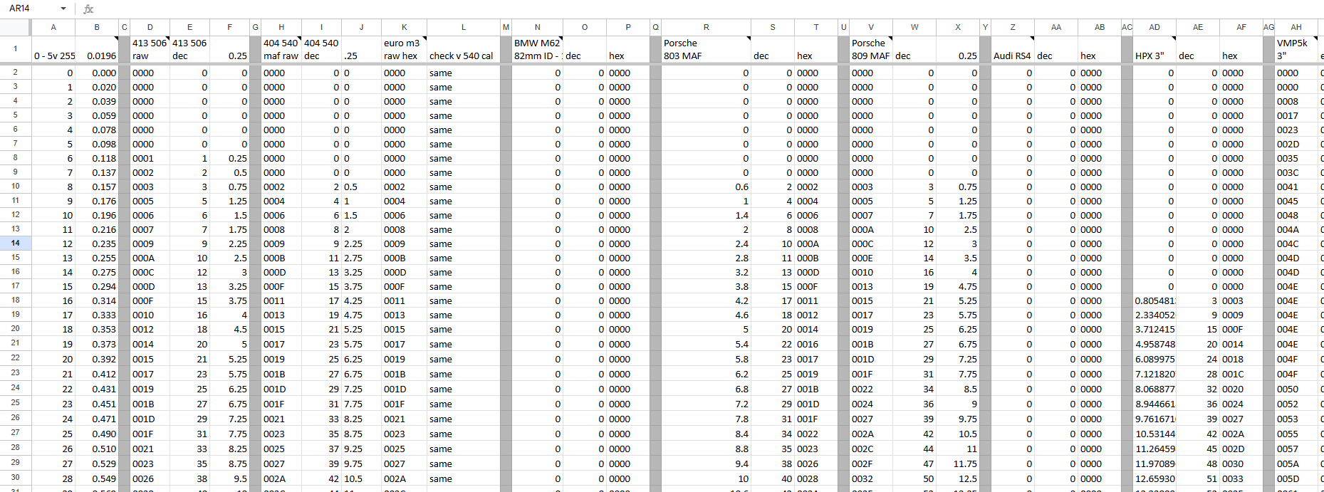

Worked a bit on MAF selection sheet and the database of MAF calibration data sheet. More to come. Thanks to ba114 and the MS41 community for a lot of info. Some data if from other sources, some I have personally verified in multiple ROMs, and some from MAF companies.
I have focused in on there most common MAFs and the "best" MAFs.
I have reread a lot of old thread on 540/Euro, 803, and 809 MAFs. With the knowledge I now have from going through a lot of ROMs it's cleared up a lot of confusion.
First 540/Euro MAF the volt vs airflow data stored in the ROM from a 540 and a Euro M3 are exactly the same data. I have read the ROMs myself and checked the data. It's provided in the Google sheet linked in first post. Second this MAF is only viable if you get it cheap and you are doing NA only. This MAF only adds 50-80kg/hr of head room total. The errors start well before the kg/h listed at 5V. The max threshold error limit in the ROM has to be adjusted to do a MAF calibration for a higher flowing MAF. With that known, you can change the threshold while retaining the stock MAF and get almost the same max airflow as the 540/Euro MAF. Unless the bigger diameter actually comes into play affecting the power output there is not much reason to go to a 540/Euro. The 540/Euro also does not have enough flow capacity for boost application. For the cost cutter budget people you could do resister mods to pull down the voltage and make a customized calibration, and accept the cons of losing the low end tunability. There is a sheet with a tool to help with the(lifted from ba114).
You can also see the 803 MAF does not have a lot of headroom for boost. The car it was on was only in the mid 200s... I only have ba114 calibration data on the 803 MAF. I have a few ROM dumps that should have the data but I cannot find it...unless the ROMs I have are not right. This MAF has just a little move head room than 540/Euro MAF. 803 would need resister mod to run much boost.
809 MAF finally enough room to run boost but if you want big HP it's still not a got enough airflow range. The data in the sheet is pulled straight from a Porsche 993TT ROM that I did myself to confirm data posted by others. I'll post the ROM and the XDF(that only has the MAF data defined).
So that leaves you with what I think is the best options if you want to change MAFs. HPX or VMP MAFs that come with calibration data that can be adjusted for the intake tube size you want to run/what HP capacity desired. There maybe some other MAF brands that are viable, please mention them and I can add to the spreadsheet(and later to calibration setup information).
I do a little professional work with newer frequency based output Bosch MAFs and have a little better understanding but, there is a lot to learn for specific applications.

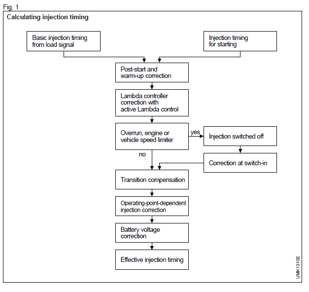

The Bosch book about the M-Motronic system that all that enter should read
https://e28goodies.com/wp-content/uploa ... uction.pdf
Two flow charts that set the foundation. The BMW software is customized off of the base system so remember your grains of salt.
Fun here is that the way Bosch words it the LOAD signal in the output of the MAF. MAF signal is Load in the Motronic system as stated by Bosch. The history of 413 tuning like many other communities has call the "basic injection time" the LOAD. It can be seen as a processed and converted load indicator(given your injector size and fuel settings). This one reason that I believe so many are confused from the start.
So maybe a better description of the main fueling table axis(and all that are indicating a load level) would be:
RPM vs. "Basic Injection Time Calculated from MAF Load signal with Injector Size Constant and Fuel target AFR Accounted For'
That is a mouth full though.... SOOOOO...."LOAD"
inj time flow chart.PNG (26.84 KiB) Viewed 127129 times

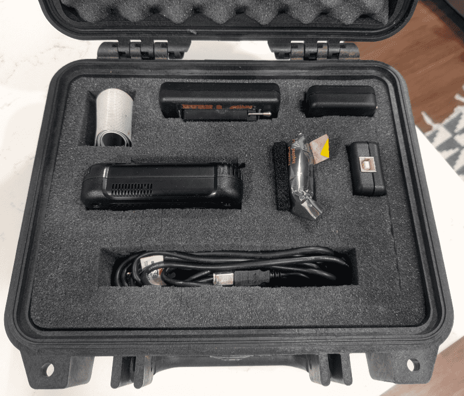

Put my hardware kit in a box. The universal programmer XGecu T48 is a good option. With Moates back in business the burn2 is a nice small and very easy to use product cost a bit more than a T48 but the software of the t48 has a lot going on that could be confusing...and just seems a bit sketchy.

OOOOOOh. NICE! I have pretty much all of it already. The Moates website is supper slow to load and sometimes getting cloudflare failed to load issue. Maybe website is having issue.
The Burn2 is super easy to use for the specific use case. The T48 has more capability and is lower cost.
I have always questioned the CobraRTP products and been grateful that I had no need to buy them since I have the Moates Ostrich 2.0 already. Seems CobraRTP is out of stock of everything anyway.

I can't help but look at MAF data. I am a LARGE MAF ENTHUSIAST.
This is a table based on the MAF data I have for the HP estimate that you would hit the error limit of the MAF...when you set the max flow to the 4.75V flow. You could push higher into the voltage range but you have to leave some up there I think for noise overhead and the like. The stock settings limit for the M50tu I believe is 750kg/hr or ~ 4.25v limit. So the biggest gain for the stock/540/euro MAFs comes from editing the limits in the DME not actual hardware(ignoring potential efficiency increases from the larger diameter MAF)
This assumes no resistor mod. It is known that when the 803/809 MAFs were popular that resistor mods were used to change the measured flow range.
The 803/809 MAFs are $$$$ now and not worth it for turbo application, Plus the hassle of developing a your own resistor mod + custom MAF calibration to suite. The 540/Euro and m62 are good candidates for high output, high rpm NA builds.
The HPX and VMP5K are now the obvious choices for turbo builds given the cost and data given. Each can adapt to your HP goals with a housing size + calibration change. Calibration data tool are provided by the manufactures. You can further down-select to the VMP5k 3"(tube) if you want to run 3" charge pipe and be north of ~575HP, from these estimates anyway. The HPX would need a little larger tube to measure up there or, take a look at the HPX-E version. HPX-E will be a lot closer to the VMP5K with a 3" tube, Calculating for what size charge pipe would be the most efficient in your operating range is probably a good idea before you spend spend spend.

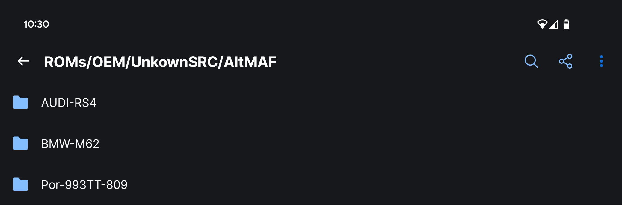

Started adding a few of the other cars OEM bins that are the source of MAF data to the GitHub link in first post. There are posts with converted data around to compare to. If you go about checking it all yourself befor using you will notice that is a bit of conversion error is brought in. A few kg/h difference can occur depending on how you do it. I recommend checking and making sure you agree with the data before using

Have been adding several items in my WIP version of the 413/623 xdf. I have a lot of touch up work to do yet but I am running out of new sources of information without a ton of real car test time, a SIM bench + the time, or diving into the program disassembly time sinks.
I started to wonder how much of the calibration data the community has defined over the years. Excluding the program portion, just the calibration data.
~67% has been defined. I did given some 0.5 scores on areas that are only sort of known. Sure there are some mistakes in there. I am working through table by table cleaning up and doing sanity check on them.
how much we know result.PNG (3.9 KiB) Viewed 126664 times
how much do we know.PNG (58.73 KiB) Viewed 126664 times

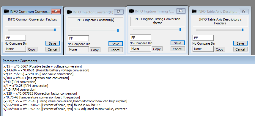

Adding more info to the XDF where I can. I am bending the proper use of the XDF a little trying to make it a one stop shop for information.
info example.PNG (31.87 KiB) Viewed 126664 times

I have been trying to resolve the injector constant into its parts. It much be made up of a value representing the injector size, unit conversion factors, number of cylinders, stoichiometric ratio(possible the value stored in the ROM is used), and revolutions per cycle. Google gives results with many attempts that do not work out...so far. I'll come back to this later. Driving into MADNESS:
calc madness.PNG (72.18 KiB) Viewed 126246 times
I have also been comparing may files and have noting settings that are being changed when the injector constant is changed. will have to make a second pass on this and note the ones that are scaled by the injector constant changes and items that are changes in a different way.
unknown settings possibly injector scale related.PNG (83.13 KiB) Viewed 126246 times

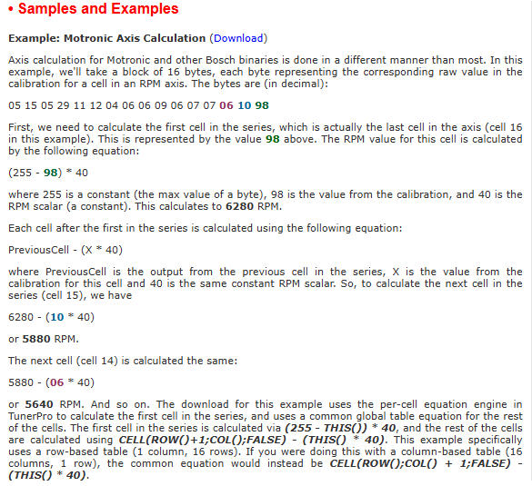

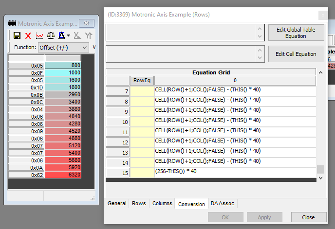

Per my other thread about TP handling of cell equations I have found that 256 is used in a bunch of equations and it most likely should have been 255.... great.
nomecone wrote: Thu May 01, 2025 5:37 am I crossed this...
https://www.tunerpro.net/examples
Note here the use of 255
motronic axis tp.PNG (43.17 KiB) Viewed 125897 times
Then in the example files linked on the page 256 is used
motronic axis tp 2.PNG (37.47 KiB) Viewed 125897 times
255 seems to be correct to me. Max value is FF = 255
(256-255)*40 = 40 this does not seem right. Should be zero.
(255-255)*40 = 0 this seems right to me
Looks like most if not all motronic xdfs copy pasted from the example file and now have 256 in every occurrence of the equation. Not my favorite type of fix to make. WHOOPY. Maybe time to cross the line and hand edit the XDF in Notepad++
I do not really want to be a perfectionist. I know I am still making mistakes. My plans however are to finish 413/623 then apply that info to all the BMW motronic 3.x versions. I do not want to keep propagating errors. I have been having good luck with writing scripts to parse the ROMs. End goal is something that can output an XDF based on the ROM or a file based on the ROM that Tuner Pro can import. I would also like my scripts to be useful if you want to use ROMRAIDER or other apps I have yet to explore, generally make as much of the BMW M3.x info available to everyone as I can. Right now I am 413/623 and TunerPro focused.
*update* still hard to say what is right. Rpms look "cleaner" when its '256-' and I do not get any issue with conversions. '255-' makes some axis start at zero which make conversion calcs based on RPM ugly. mult or divide by zero. So what is 40RPM difference among friends?

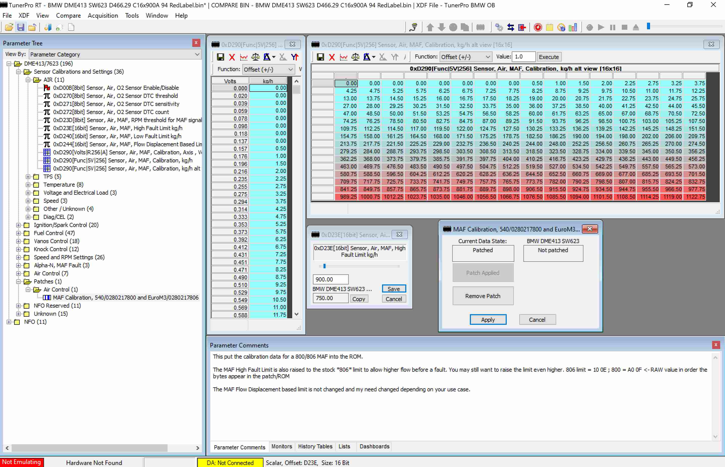

I played with making a patch in TP to see what it was like. Bit of a hassle but can be made. I used the MAF calibration as my test subject. First thing I found out was the patch appears to be limited to 256 bytes. MAF cal is 512 so it take multiple entries.
I am using the 540(800)/EuroM3(806) MAF cal data for the patch. I made the cal change then I moved to checking the new MAF high fault limit in the 800/806 ROMs. Turns out that although the cal data is an exact match the MAF high limit is set to a different value. This makes sense. I went with the 806 high limit setting for this test patch. I patched, I un-patched, and used to compare ROM/BIN to make sure it was doing what I wanted the patch to.
I think this was the sort of thing that was the wet dream of the BF tuning threads 15-20yrs ago... "Somebody could make an xdf and just make patches so we could easily swap common parts instead of buying a $$$ chip tune every time a part is changed" ... Well, that never happened publicly until now - 15-20yrs too late to be cool.
Before the patch
Patch applied
Patch Setup
Some other generic patches should work fine. (Idle RPM for light flywheel, RPM limits, Speed limits, etc)
I would like to collect the data needed for coil swaps to have patch data for those.
I would like to better understand the TPS so other TPS/throttle bodies could be calibrated and patched in.
The injector constant change....the TunerPro patching mechanism is unlikely to be suitable for this...but I will look into it anyway.

Updated vin2hex sheet to a sane conversion. The other worked but was using a wild method that I found. Understanding the binary conversion is much better.

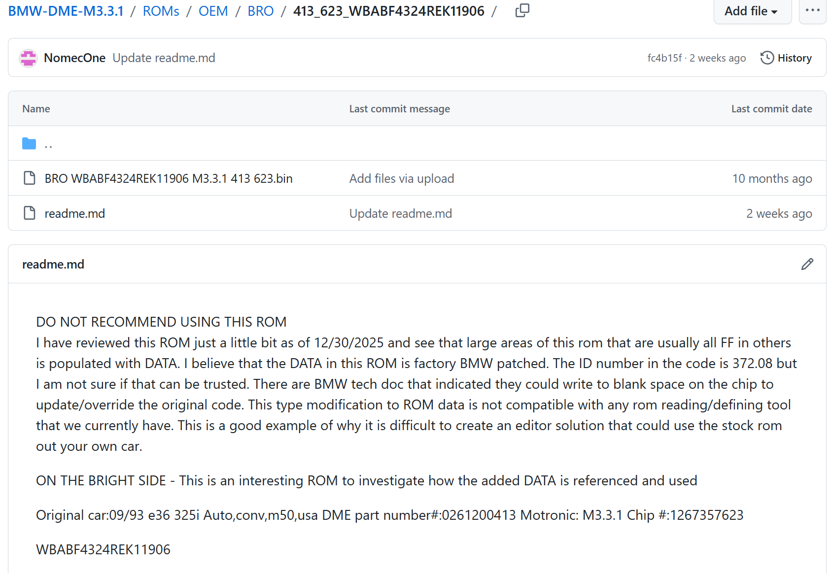

***SIDE NOTE***
I updated the note on a stock OEM file thatis on the github
Screenshot 2026-01-15 041719.png (200.62 KiB) Viewed 84812 times
