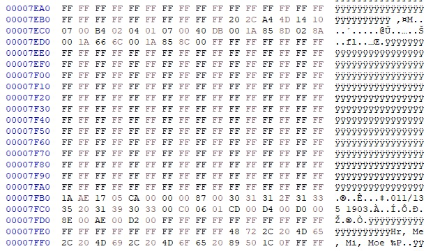

Here is the stock tune file for you to see if you have time:
https://www.upload.ee/files/13817304/St ... 5.rar.html
This is how the file ends:
to compare, this is how 402 ends:
This must be a 32kb file..

What XDF you are using to edit that bin? Chip number in this rar file was 1267356548.
Re: 405 ecu checksum problem?
Checked:
XDF for -951.bin will mess the -548.bin file, because in -548.bin the checksum is in different address. Data end = 0x7BF7, store address = 0x7BF8.
Looks like XDF for -951.bin fits at least partially, ignition tables and fuel tables seems ok, so change that checksum address and keep in mind you are using XDF for different bin file.
