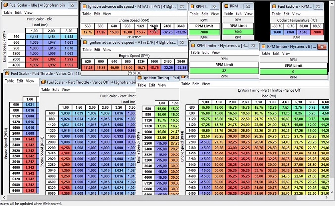

Re: 506 revlimit hysteresis and ignition cut instead of fuel cut
tried this for pop and bang but engine backfire from intake manifold
what is wrong or how can i make it ?
- pop test 413 - Copie.jpg (189.71 KiB) Viewed 15567 times
Lower fuel on deceleration zone and increase ignition retard to -22 at least part throttle. The max retard on 413 and 506 is -45 do that for idle when vanos retarded
It shouldn't pop from the manifold
