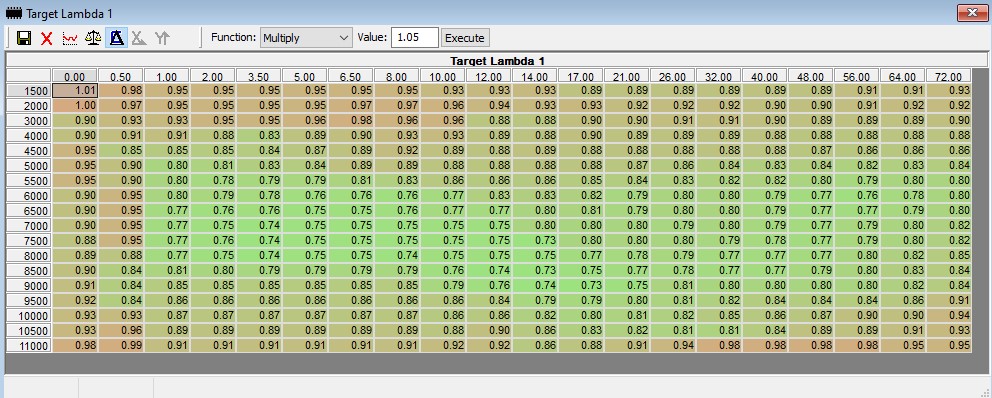

I am also trying to figure this ECU out. Bought a XDF from Oldskulltuning who hangs around here. The maps are identified correctly but the map offsets are not correct atleast not in the ignition map which makes me unsure about the rest.
I have also spent some time in Winols trying to identify further areas of intrest:
HEX: 0a000 12x8 16bit
HEX: 08410 20x18 16bit
It is repeating itself just like several maps do i guess due to map1+2 selection
Posts: 347
Re: KTM TPI Continental Synerject M3C
Dear customer,
map offsets (start/end address of maps) are 100% correct, also for ignition maps.
About this address: HEX: 08410 20x18 16bit
it is already present inside our xdf, named "target lambda", see attachment.
It has been double tested with our customers.
If you have any question please feel free to contact us by email: oldskulltuning@gmail.com

Thanks for a swift reply both here and in the email. I am a happy customer. The reason I don't believe the first ignition advance numbers is that almost all 2 strokes have a 5 deg ignition advance at 0%TPS/1000RPM and the map indicated 15deg at which point the engine would be almost impossible to start.
