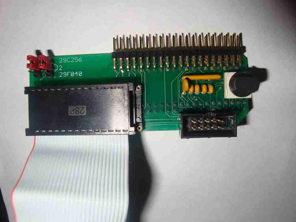

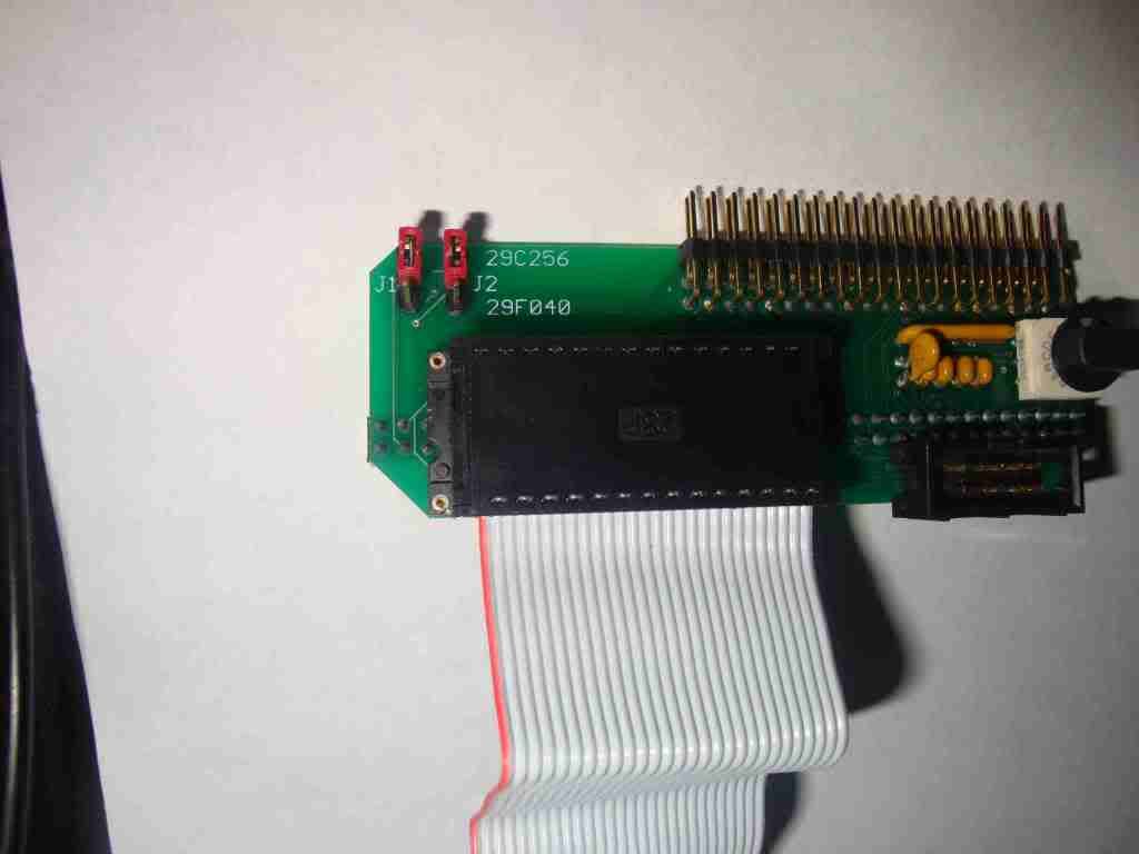

This is the way I thought it was supposed to go:
http://i377.photobucket.com/albums/oo21 ... n/left.jpg
Because when I tried it like this:
http://i377.photobucket.com/albums/oo21 ... /right.jpg
and keyed on, the fuel pump relay rattled and fried. Then the pump would run continuously till crank then startup with a large carbon footprint! :?

Post by Six_Shooter »
You're showing the same position in both of those pictures.
There should be 4 exposed socket pins to the left with the G3 in the same position it is in the pictures.
