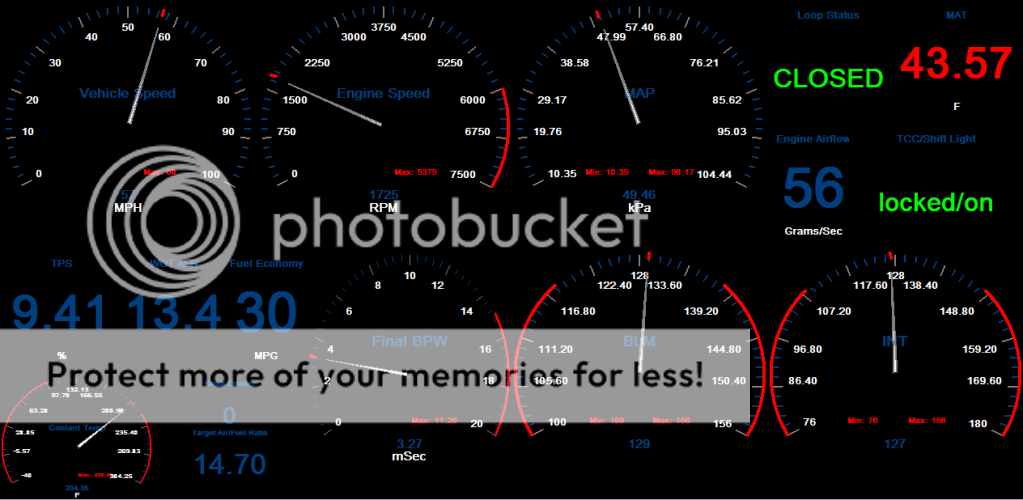

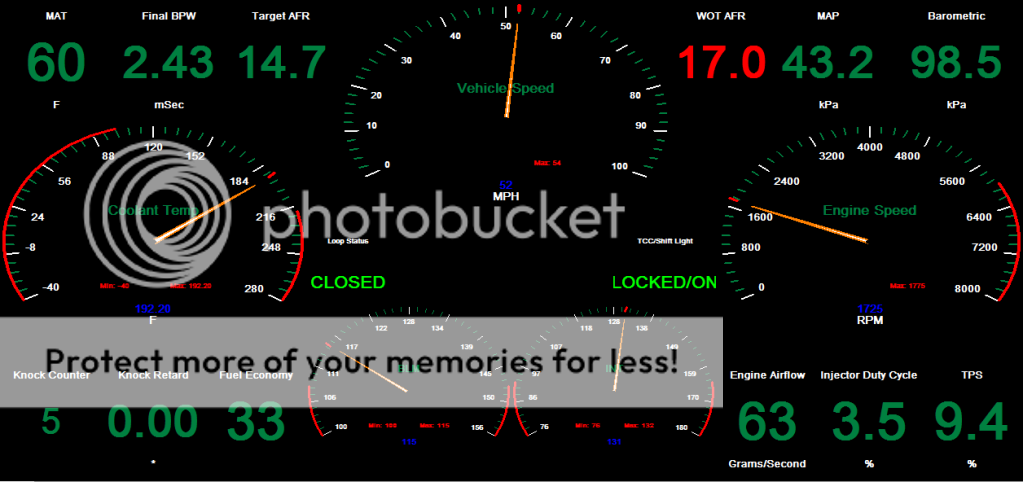

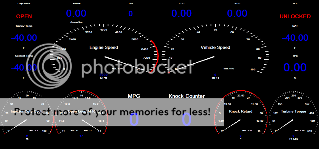

no, no actual tutorial other than Sil's i think... that's for scannerpro, but the process is similar.
http://tunerpro.net/forum/viewtopic.php ... highlight=
and for some "inspiration", here is a few that were made by a few other members.
and here are the old versions of the ones i use regularly or have made recently.
http://i598.photobucket.com/albums/tt68 ... ar/5B7.png
http://i598.photobucket.com/albums/tt68 ... mcdash.png
http://i598.photobucket.com/albums/tt68 ... r/dash.png
