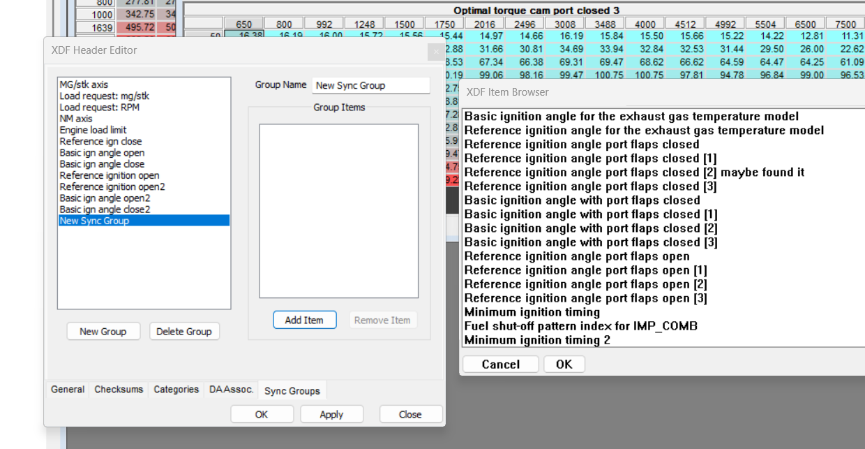

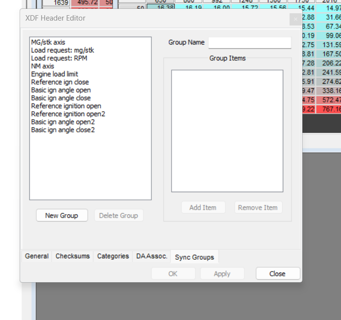

yes! one of the other posts I made recently about CTRL selecting or shift selecting to do more then one at a time
if you do ctrl + f2 or goto the xdf menu then xdf header editor then goto sync groups
Screenshot 2024-09-17 151319.png (109.19 KiB) Viewed 22058 times
if you hit new group then you can name it where it says group name and if you hit add item it'll bring up the xdf item browser currently you can only select 1 at a time and it's stuck in list view organization which sucks pending how organized that is haha. alphabetical or category view would be wonderful.
once setup when you change 1 map in the group it'll ask if you want to sync to the other maps when you save it. this also works even better when you also map the axis separately then use the linked, scale label source then brows to find the table you made to represent the axis because then you double click on the axis and it'll change the main axis but you can like multiple axis together :) so that way if you start a new xdf you only have to find the address 1 time once fully setup :).
kind of a pain and lots of front end leg work but once setup SO much easier
