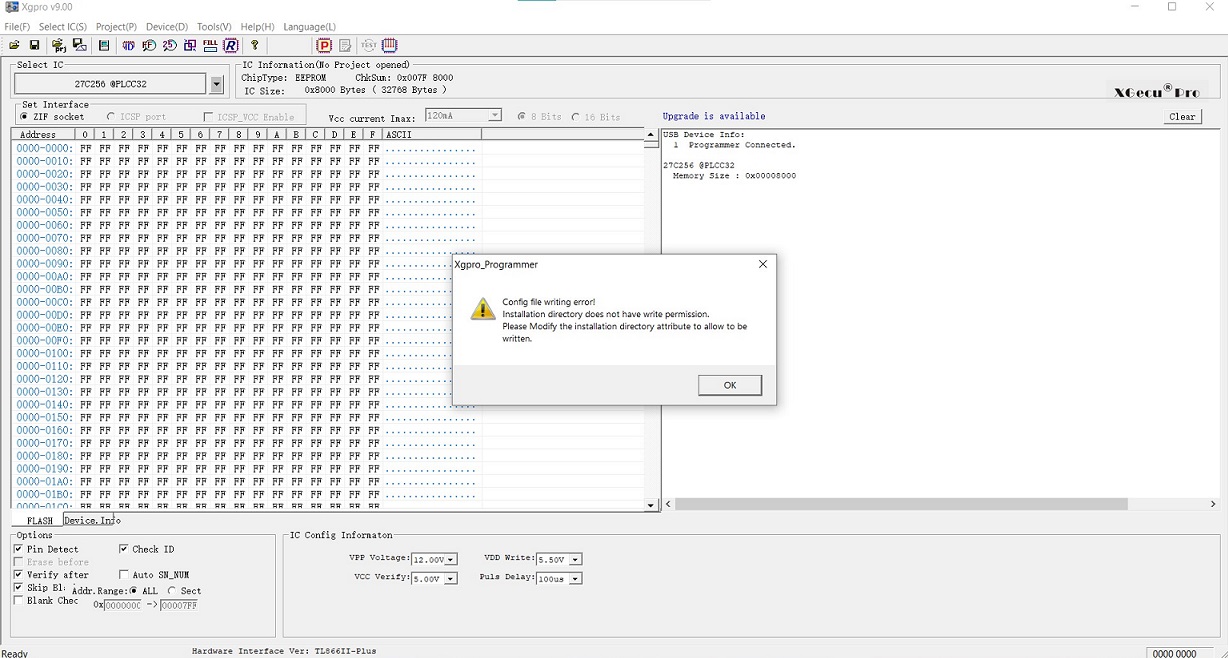

dex wrote: Tue Sep 22, 2020 7:36 am The Moates Ostrich 2.0 is an 8 bit emulator (it can emulate 27C256 EPROMs) and it cannot read or program chips.
Hello again,
I have since bought a cheap programmer and successfully programmed a blank chip, unfortunately it isn't electronically erasable but that's besides the point.
This screenshot is from the programmer's software, what does it mean by the 'installation directory'? I'm trying to read the factory chip from the car and it won't do it.
Config Error.jpg (229.69 KiB) Viewed 19592 times
I know this isn't a Tunerpro issue but I appreciate any help thank you!! :)
