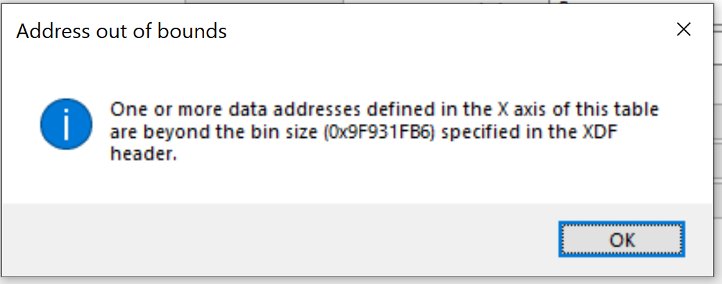

For whatever reason, I am unable to edit or create any Tables.
No matter what, I always receive the 'Address out of bounds' error.
The only way I can edit XDF, is to do it manually.
I have 100% reformatted my computer, reinstalled windows10, updated, downloaded and installed TunerProRT from web, and same problem.
This error happens when I just want to change the name of a table or description, does not matter what I change, clicking OK or Apply says its out of bounds.
It even fails when table edit parameter xdf info, add a space in description, remove the space so nothing has changed, click apply or ok, and 'Address out of bounds'.
This only happens on Tables with fresh install of everything.
Build 5.00.9290.00 is the version I'm having an issue with.
Build 5.00.9209.00 works fine.

Thanks. Fixed in the next build. This only affects XDFs with a base offset set.

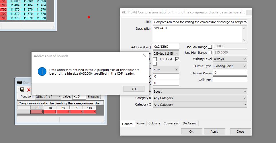

I am running into the same issue on the newest version?
i removed the base offset ( it was 0 so it wasn't doing anything anyways please help!~ haha thank you again for all your hard work I kept increasing the size and it still does it lol so i'm not sure what else to do

how many rows and columns? multiply those together, multiply that result by 2 (since each is 2 bytes), and add it to the base address. If the result is the same as or larger than the bin size, then the error message is correct.

unfortunately it's on anything and no matter how big i put the size as you can see in the SS i posted it was a 5x1 table that times 2 is 10 adding 10 to the base table address of 24DB60 is no where near the 32000 bin size. I believe the SS gives you all the info needed unfortunately it's not "correct" even a 1x1 on a brand new def with a size of 32000 gives the same error

anddd i'm dumb LOL i just noticed it was 32000 instead of 320000 so technically it was under the amount listed ... my apologies i tried to recreate it from scratch and i was like well WTF lol
