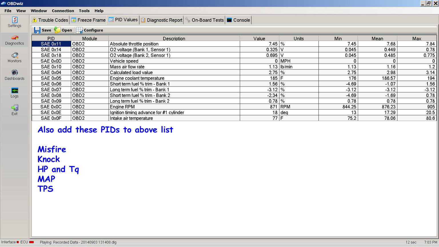

If you mean the OBDWIZ scanner software that comes with the OBDLINK interface
Use Config to add these PIDs
OBD2 PIDs
OBD2 PIDs

i know this an older post but I have a similar issue. How do you add pids to OBDWiz that arent there? The lack of knock has annoyed to hell out of me. I've always logged ignition timing to look for the evidence of a knock.
