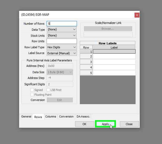

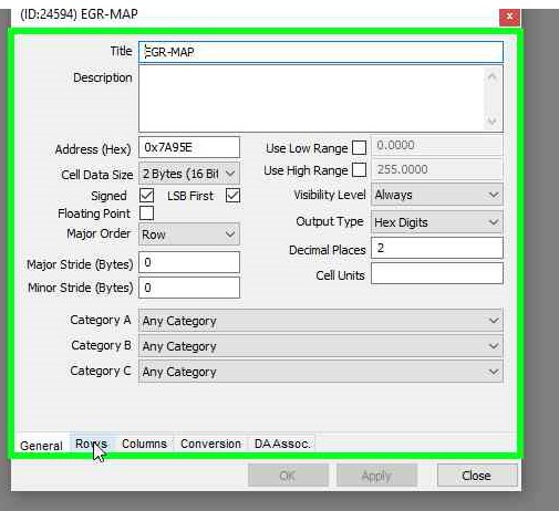

I have the exact same issue. In my case it happens when changing rows or colums.
I attached two screenshots, where this happens. After clicking apply the software shuts down without error or messagebox.

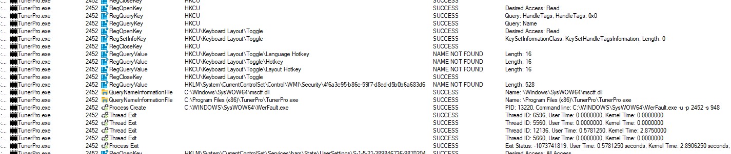

Processmonitor shows only this:
Screenshot 2021-11-29 170631.jpg (150.82 KiB) Viewed 23242 times
