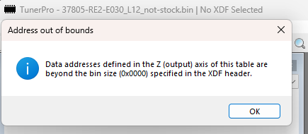

ROM loaded, reporting Addesses out of bounds, bin size (0x0000) when trying to create tables
darkcashyz
Joined: Mon Apr 25, 2022 10:32 am
Post by darkcashyz »
ROM loaded,
But TunerPro is reporting Addesses out of bounds when I try to click OK or Apply when creating table.
Reported bin size in the error message is 0x0000 which is not correct.
Build 5.00.9685.00

I'm sorry it's my own fault. :D
I did not define Bin Size in XDF header information.
