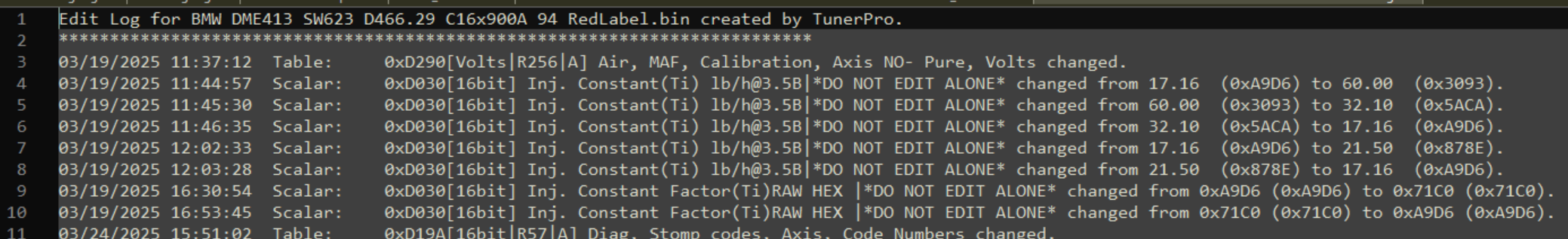

There is also Tools>preferences>general [X]Enable Edit Logging
it makes a log file of all changes made to a BIN file
